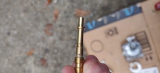

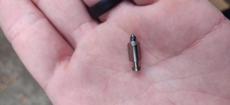

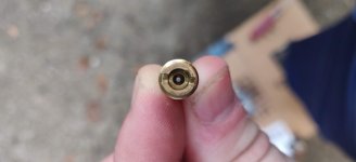

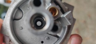

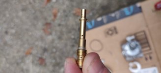

Amen Bert.
Engines start off the pilot or low speed jet. These use tiny pilot jets and clog easily. Same as the emulsion tube you showed in your pictures.
What you've shown looks clean. Need to clean what you haven't yet.
Hope you kept the original magneto. All you had to do was de-rust the mounting areas where the 2 screws go. This improves the ground to engine block allowing current/voltage flow. Course the coil could be shot too.

Amen Bert.
I have the original, I will keep it just in case I need a backup.
However, after four good cleanings it was the linkage that was the issue. Turns out the choke linkage had come partially out of the slot it is supposed to slide in, causing the choke to not engage.
