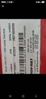

  • / 2014 troy bilt pony Did it come with deck wheels on it !!!!
Here it is sir
123
12,913
Even though cutoff the first characters here is the IPL Picture. Unless someone stuck another deck on it.
Now here is one off a 2020 model that didn't have deck wheels which looks more like the image you posted.
Note the deck engagement cable is in the center of the deck instead the left side.
