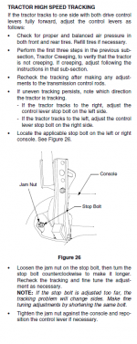

I just bought my first zero turn, a 2006 Troy bilt 50” deck 25hp Briggs. Model number 128976. I am wondering, is there a way to adjust the arms? What I’m asking is because the right arm has more forward ‘throttle’ than the left. It also has more forward travel than the the left. So if I push both all the way forward, it drives with a slight push to the left. And in reverse, the total opposite - the left has more ‘throttle’ than the right, and also has more travel than the left. So I’m wondering if there are any adjustments that can be made to correct/counter that? Thanks for all the help!
