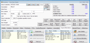

BINGO, IL that non-exsistant relay....Burned contacts causing it to over heat. And Cub Cadet tried to get me to buy a complete wiring harness to replace a $2-$5 relay.
And no Rivets that not the relay. It is MTD PN 925-1648 which crosses to CM-1-R-12V.
Here is a list of all the available crosses I have found so far.
