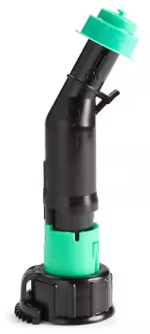

Sealed gas can spouts helps too. Replace all your old open top can spouts ASAP.
