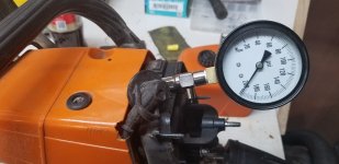

20210206_162104.jpgthis one is a little higher than than 7.5:1
