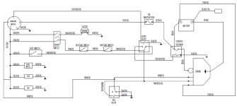

I have a Hustler Raptor X zero turn mower model # 939694 with a Kawasaki FR600V 18HP engine. When I try to start the mower I get nothing, just silence. However, if I turn the key to start 20 to 40 times, one time the engine will crank, start, run fine all day; just don't turn it off or it's the whole no start cycle all over. Figuring an intermittent connection issue, I replaced the seat switch, the 2 handlebar switches, the ignition switch, the PTO switch, the starter solenoid and a new battery. Mower lives in a shed, so no corrosion anywhere. After replacing all those parts, I have the same issue. Turn the key=silence, turn again=silence, 20 to 30 turns later, the engine starts, runs great, lawn mowed.
What am I missing here.

I recommend you research to find a wiring harness for your model. There is likely a delay cranking relay or bad diode in the wiring circuit.

I'd get the VOM out, hook it up between ground and the solenoid, then turn the key. If you get 12V then you put the VOM on ohms and check between the negative battery post and the starter case. If you have a good ground check between the negative battery post and the solenoid ground. That will tell you that you have 12 V and the starter and solenoid have a good ground. If you do not get 12V then you chase back to figure where it is being lost. If you don't have a good ground then you clean all the ground straps. A friend had a bad starter once. He replaced it. Drove him nuts trying to find the problem. It was too much paint on the starter and bell housing. Cleaned the paint off, good ground and all was perfect. In your case does your engine have an oil pressure or level sensor? They do go bad. Alternatively you can feel the solenoid click when you turn the key. If it does not, then your problem is between the solenoid and battery. Could be a wire that frayed or a mouse who visited you.
And you haven't replaced the starter relay which may not even be operating or have burned contacts.
