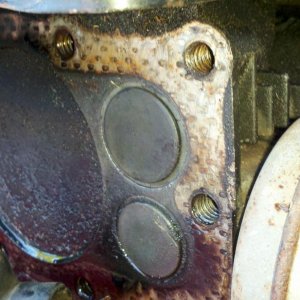

After I re-seated the valve seat, some center-punching and lapping, all is well.
Mad-Mike
Jun 19, 2012

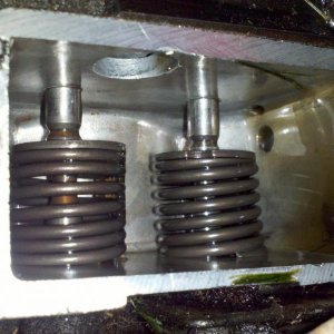

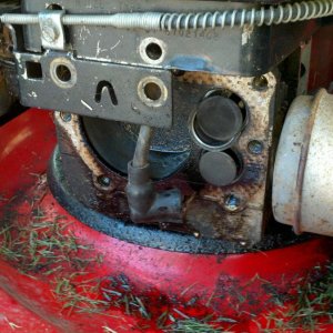

Valve chamber - intake valve is stuck open, causing the engine to backfire through the carb.
Mad-Mike
Jun 19, 2012
The valve seat is holding hte valve open. I fixed this by re-seating it and hitting it with a center punch where it meets the block.
Mad-Mike
Jun 19, 2012
The valve stuck at the start of the season, had to re-seat the valve-seat
Mad-Mike
Jun 19, 2012

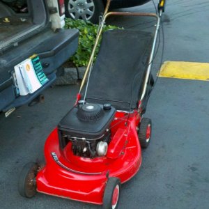

Ready to pack in the truck
Mad-Mike
Jun 19, 2012
Getting Ready to Go mow my friend's yard
Mad-Mike
Jun 19, 2012

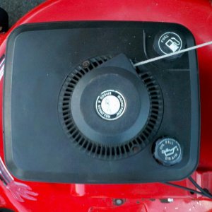

4HP B&S MAX

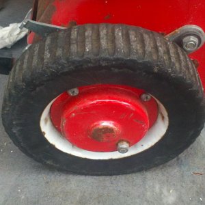

Rear Clicker Wheel

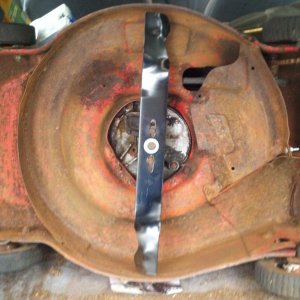

Clean inside with New Blade
Mad-Mike
Dec 6, 2011

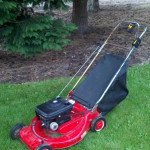

1987 MTD 127-362-013
16
Mad-Mike
Dec 6, 2011
Currently my only mower.
4HP B&S MAX (110702)
22" Cut
Oregon Hi-Lift Blade
Modified "flip-top" catcher
Clicky wheels & "Sunny" hubcaps
Mad-Mike
Dec 6, 2011
