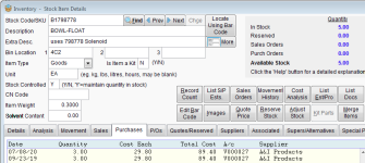

It is when you need a fuel bowl it gets out of hand but I am still sitting on 5 ea 798778 fuel bowls with solenoids for the dual barrel carbs that I paid only $30 each for. I even got 3 ea of the 698783 fuel bowl for singles that all you got to do is drill and tap @M8-100 for the fuel solenoids.
Now these dual barrel fuel bowl kits are current priced very high so I can make a killing on them when I sell them @ $135.00 ea. Also their PN was superseded to the fuel solenoid PN; hence, the note of uses is the same PN. Besides I can be just as greedy as the next fellow when using price files.
