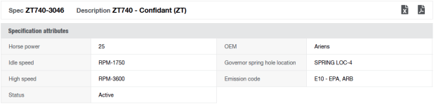

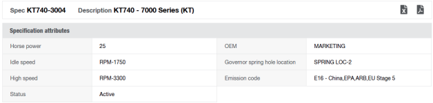

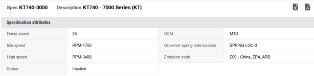

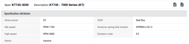

Just because the service manual says 3600 rpm doesn't mean that your particular was spec'd to be set at that speed. Here I look up the engine per their spec numbers on the Kohler's dealer website.
And setting the speed the engine's spec can cause other problems as the equipment manufacture was keeping things within the max rpm limit for the hydros and the deck blade tip speed. Running the hydros above their safe rpm can lead to early failure just like running a sustain minimum speed.
Examples of a few of KT740s is

For your particular spec you set it right. Just like to check things before I type specs. Just too variables to remember off the top of things. I rather look bad by posting the right info then post bad info.
