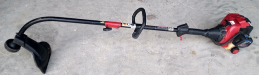

I have a string trimmer that had been sitting for a long time, and I thought I would try to get it running. I did the usual: cleaned the fuel tank, replace the fuel lines and filter, replace the carburetor, and fill with fresh gas/oil mix, but still no good. I pulled the engine to look at the piston, and sure enough, the cylinder was pretty scored up. I replaced the short block with a new assembly. The new assembly came with a new spark plug and coil pack. I set the coil spacing with my brass feeler gauge. I verified spark was good at the plug, and the compression built up to about 120 PSI, after 4 or 5 pulls on the recoil rope. Oh, I also verified that my primer bulb circuit was flowing a nice stream of return fuel to the tank. After all this, I am still unable to get this trimmer started. I started with the customary 1 1/2 turns out from seated on the low and high speed jets, but still no signs of life. So, I have spark. I have fuel. I have compression. And . . . the fuel mix that I am using works in my Echo leaf blower. Any thoughts on this?

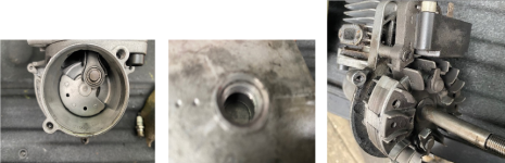

I tried putting my 2-cycle gas mix directly into the cylinder, but had no luck getting the thing to fire off. I double checked my spark and checked my spark plug gap. All good.
Below are some images of the short block I removed. I compared the location of the piston in its stroke to the feel of the permanent magnet passing the coil, and both the new engine and the old engine seem to be showing the same resistance, in the same cycle position, when the permanent magnet passes the coil. I am at a loss . . .

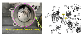

Other than sealing out debris from the crankcase, does the rear cover o-ring (#4) provide any sealing properties that require a tight seal? Fuel delivery is created by the downward stroke of the piston, correct?
123
12,917
This is a two cycle engine and crankcase is part of the intake system so yes that cover requires a tight seal.
With fuel directly introduced it should had hit if the timing is correct even with the crankcase partially unsealed.
I'm not there to look for myself but something is definitely not right.
