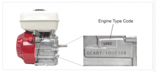

Besides just the model and serial you must use the spec alpha/nurmeric number to get the correct IPL.
119
12,737
Generally it is in the same area as the serial number. Example below.

StarTech, the only other thing I found was S3B* after the model/serial stamp. I don’t mean to pester you with this but I’m trying to repair this for someone that really needs it.
119
12,737
Your not being a pest. I know I have to nitpick the info but there is a reason as I got the verify the correct carburetor PN.
You have either a GCV160LA0 S3B or GCV160LA1 S3B but both of these S3B type uses the 16100-Z8B-901 carburetor and not the 16100-Z8B-003 that you have on the engine now.
