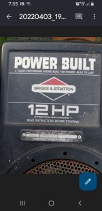

So I have an old snapper rider and all tags or identication are completely missing. I'd like to know what model I have? Here are pictures of anyone could help.. I don't know what belt I need or replacement blade size

It's most likely a 3311X5S.

It looks like a 33". Take the blade off and measure it. For years Snapper put the tag below the battery. The acid took care of the tag. I think I still have a belt hanging on the wall for a 33".

It is a 33" deck with a 12HP engine produced in 1996. The handle make it a series 6 or earlier but the series 5 used an 11HP engine.
So it is more than likely a 3312X6S. Belt part number 7010749YP.

Having been a Snapper dealer up until the early '90s, this mower is right in my wheelhouse. The last round tube mowers (with the exception of the re-introduced "classic" models) was the series 6, and was last produced in the late '80s. IIRC, the series 6 had only one pedal, with a latching mechanism to lock down the clutch/brake pedal. Since this mower has two pedals, I feel it is a series 5, and would have been built in about the mid '80s.

Measure the blade to be sure.
Engine is a 1996 Briggs. Take care of it. Don't make them like that anymore. Could be a repower possibly.
What is throwing me is the skinny left rear tire. Looks like proper right rear I think. Pictures are throwing me off. The 33" normally has wider meats on the rear.
