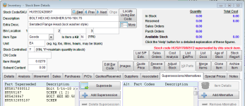

They appear to be a thread forming (self tapping) screw.
I'd try some blue Loctite and see what happens.

Yes it is a self tapping screw. Yes only Blue Loctite as Red is permanent especially in aluminum. IF hole is worn out then you need to resize for a standard next size screw or Helicoil it and use a standard 5/18-18 x 3/4 grade 5 or grade 8 screw.
IF going to next size then use a M9 or M10 screw depending how bad the hole is worn.
