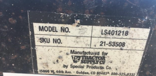

Have a roughly 30 year old 34 ton Huskee Log Splitter. Origional engine which was a 10hp B&S Insustrial/commercial vertical shaft blew about 12 years ago. Took to a repair place which switched it out with an old 11hp (not industrial) model that has always been unsatisfactory, it has been ok but is tired. I would like to find out what model the origional engine was so I can look for a proper newer model. If anybody has the same Huskee Log Splitter (model 21-53508) I would appreciate if you can give me some info regarding the origional engine that was on this model. Thanks in advance for your help.
mahnoo51
May 22, 2023
My Huskee splitter is a 34 ton, not a 35. My Model # is 21-53508). Also the origional B&S engine was a 10hp I/C vertical shaft so I don't know if what you suggest is the one I'm looking for. Do you think you can help me find what would have been my origional one?

1684798522492.png.
mahnoo51
May 22, 2023
Great 😊. Please let me know what the model number of the motor is on that one.
82
10,392
Well info on this SpeedCo Log Splitter is basically none exist and SpeedCo is premamently closed. It looks like a Briggs 21R8 series is going to be you best option but need to verify crankshaft diameter as the 21R8 series have an one inch PTO end. This engine a 11.5 hp gross engine. And come with and without a muffler and no gas tank.
The 21R807-0072-G1 is the current Promo which is the best priced engine and it does come with a muffler. PTO is 1 x 3-5/32 so might need to be shorten depending the current pump setup.
