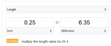

I used an electronic caliper and it showed .09 inches. So is that like 1/4 inch or 3/8 inch or 7/16 inch or what?

You need to remeasure as your reading is less than 1/10 of an inch.
