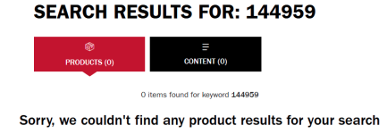

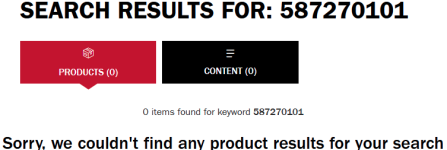

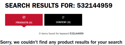

Then you find the part number of your belt
Then you go to Gates interchange web site and search that part number, remove the - and any spaces so it looks like what Star has posted & not 532 13 09-69 as it appears in the parts book
Follow the links and get the REAL specs
www.gates.com
I am yet to come across a belt that is not listed .
Also note that while it is listed as an A section, it is not a standard 1/2" wide A belt being listed at 14 mm not 12.5 mm
Also note that it is a different length so it appears that somewhere along the line an incorrect superseding number has slipped into the system as 587 27 01-01is not the same as 532 13 09-69 and more than one site has the incorrect information on it .
