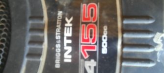

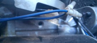

Is the block overheating?mower only works for 5 or 10 mins then it stops.
Load test the ignition coil.
Fuel tank holding grass, grit and dirt?
Block doesn't get chance to get hot.
Tank clean and new see thru filter.
Will check coil, thanks. Where is low engine oil sensor ?
Did you get your reading glasses on if required, and stare into the bottom of the tank? Or just look at the outside of the tank? Really look into the lowest part of the tank. EVERY tank on Earth will have some kind of trash in it. Unless you just rolled this off a dealer floor?Tank clean and new see thru filter.
5 minutes is enough time to fully heat an air cooled engine. Try to keep your hand on the head.Block doesn't get chance to get hot.
