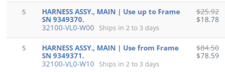

Are you seeking # 5 below? If so, here is where I found it & it is available. Inexplicably, it lists 2 widely different prices based on serial #'s. Guess you'd have to call to sort that out.
My post may have been a bit confusing. Sorry. I Need item 4, float charger, which is a bit pricey. My thought was to some how find a connector that is similar to the end connector on Item 4 in a cost effective way. I thought I saw a harness that came with the float chager but I do not see it in your diagram. Item 4 plugs into 5, somewhere to charge the battery. I need the same connector on 4 to mate with Item 5. From there I can make a cable to go to my battery charger of choice.
