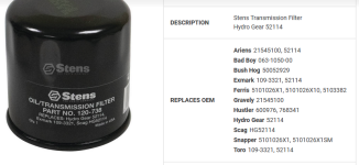

Does anyone have a cross reference for the transmission oil filter on a Hustler raptor 54 SD? Also is there a better synthetic oil for this transmission than the OEM oil?

Actual 6 digit model number please from serial number tag.

I use the Lucas 20w50 and the Wix filters, no issues.

I also use the WIX filters with no problem.
Sorry but I just noticed that no one has posted the WIX part number!
I use WIX WL10102
