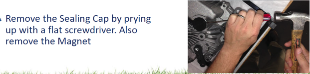

Star Teck
I removed the fan and pulley, does the fill plug just pry straight up ? Seems like l will destroy the plug if it does.
79
10,260
this is the instruction from Tuff Torq if it helps. And yes it is just a friction fit cap. Also they can be damage if old and the rubber coating is brittle.
