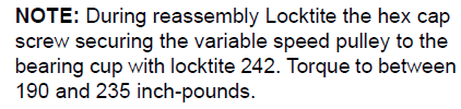

So as the title indicates, I have a problem with my Toro. The Bolt and Spacer are falling out now this year as the drive belt is engaged. My guess is the belt is loosening the bolt/spacer when I am engaging the double idler pulleys. The Nut/Thread appear to be built into the frame, unless I need to take the shell off to replace this part. The bolt will not tighten up 100% either. I'd guess it gets to about 40% torgue and then spins free again when tightening. Any advive/thoughts greatly appreciated!
