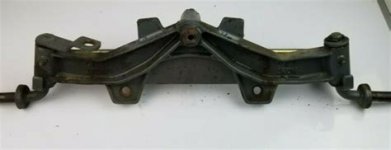

Hi, I'm hoping for some help with broken axle spindles on my S1742 and having a heck of time finding a replacement (as a reasonable price-$200/shipping is not!). My first question is does anyone know if any other axle fit this machine. The axle part number is GX10324. Next question, I got the broken spindles out of both sides of the axle; does anyone know of a set of spindles that will replace the ones that were integrated with the axle originally? I bought a pair that physically fit but the steering brackets and tie rod brackets are not in the right place. I have added a picture of the one I need.GX10324 Sctotts1742 FrontAxle1.jpeg
Speaking for myself.... I'd be photographing the "needed brackets" on the old spindles, making some measurements, and then sawing them off. Then hauling the photos, dimensions and the sawed off pieces to the local weld shop.
Ten minutes later I'd be mowing.
But, that's just how I would do it.

Now JD Parts has the axle as GY00145 but the picture shown looks more like the GY00208 from Sabre 1742.
GY00208

BornToMow, I did exactly that but stopped short of the welding shop since the original spindles are not in that good-s-shape. I'd rather new (used) but StarTech, the $408 one you found is the right one but I found the same part for $200. But, come on. $200 for a part for a 20 year old tractor? I can probably by a whole tractor on FB Maarketplace for not much more and have all the extra parts. That may be my best option.

You are never going to do a successful weld on a forged & hardened shaft that was under too much stress from the start .
No matter what rods you use a weld is still a casting and fundamentally castings are strong in compression but weak in tension and shear.
So Gwhit unfortunately you have 3 options
1) sell the mower to some one who is willing to pay a fair & reasonable price for the replacement parts
2) buy the parts & fix it properly
3) find a blacksmith willing to make bespoke axels for less than the price JD is quoting .
