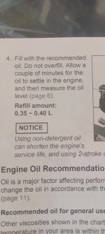

Hello, I am changing oil on a Honda HRN216VKCA lawnmower, just purchased it from Honda dealer and after my first lawn cut I emptied the oil and only 5.5 ounces came out. I think that is low and the manual says this unit should take .40 of a litter or about 13 ounces. So I put 6 ounces back in and checked the dip stick and it shows that it is at the proper level.
