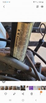

Hello all! I'm a new member here in search for some help. I have an Exmark Lazer Z 60" Model LZ22LKA604. I've been having carburetor issues and now I'm going to need to rebuild or replace. Problem being, I cannot find any applicable information about parts that look similar to my carb or engine. Can someone look at the pics and let me know if this engine has been swapped and if so, what is it? Can't find ANY numbers on the carb and no ID plate on the engine. There is a label on the oil fill tube that states that it is a Kawasaki 617CC, date of mfg 0903. There is a number cast on the lest hand side of the crankcase that says FD620D. Best I can find is that it's from a Kubota UTV?
