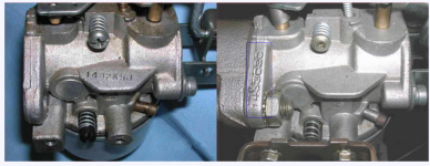

  • / Need help identifying an OEM tecumseh lawnmower carb that came off a snowblower.
Look for the manufacturing number and then post it.
But I think is a Dellorto carburetor which I have no info on.

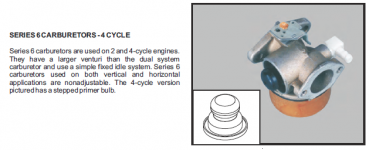

Done a little more digging here. It seems to a series 6 4/2 cycle carburetor. Try looking at the 632466 which was replaced by the 632795A.
