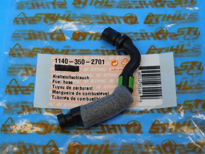

Can anyone id this hose? I think fieline but it looks bery different in the diagrams. Thanks

dougand3 Well-Known Member Joined Mar 10, 2012 Threads 12 Messages 437 Feb 6, 2020 / Ms390 chainsaw part id? #3 It's shaped like a fuel line but looks awfully short. More like an MS180 fuel line. The impulse line will be straight. The oil line is a 90* L.

B bertsmobile1 Lawn Royalty Joined Nov 29, 2014 Threads 64 Messages 24,705 Feb 7, 2020 / Ms390 chainsaw part id? #4 If the white thing is a check valve then it is the breather tube. If so the saw will not work if the tube is split

I ILENGINE Lawn Pro Joined May 6, 2010 Threads 39 Messages 9,965 Feb 7, 2020 / Ms390 chainsaw part id? #5 it is the tank to carb fuel hose for the MS311, MS391 and MS362 chainsaws STIHL CHAINSAW MS311 MS362 MS391 GAS FUEL LINE HOSE OEM NEW # 1140 350 2701 | eBay UP FOR SALE IS A STIHL CHAINSAW MS391 MS311 MS362 GAS FUEL LINE HOSE # 1140 350 2701. THIS IS THE OUTSIDE FUEL LINE FROM ELBOW CONNECTOR TO CARBURETOR. SEE LAST PHOTO IT IS # 12 ON PARTS LIST. www.ebay.com
