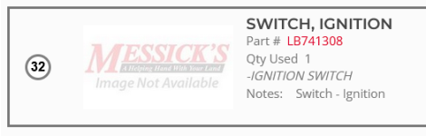

All I have is this info. Anyone know year ,model? It’s a ford is all I know. Key is missing. I’ve tried diff universals. Thank you.

According to the IPL it uses the standard INDAK keys. PN LB700172. Just about any lawn mower shop has these.
Now for the ignition switch you need to go to your local New Holland tractor parts store. PN LB741309. Around $38 plus tax

I still haven’t found a replacement ignition switch using the numbers I’ve been given.
110
12,229
Well you did not say you were looking for the complete switch, that you only had the keys missing.
You need to go to your local New Holland Tractor dealer (Formerly Ford Tractor) and ask for part number LB741308. I did mistype the PN by one digit.
