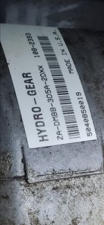

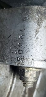

The first tag is for the left side hydro and the second if for the right (If the pics post in order.) The pic with the stamped numbers is also on the right side. Not sure if that is helpful or not. Also please excuse the bad pic of the left side with missing #'s. I couldnt wedge my phone up in there well enough.

ZA-DMBB-3D5A-2CXX
ZA-DMBB-3D5A-20XX
Hydro Gear EZT transalxes. Most parts should be available through the Hydro Gear parts distributor, just got a source that has access.
EZT Service IPL Pay attention to the decode of model specific codes above.
EZT (ZT2100, ZT2200) Service Manual
Just note these must be worked on in a very clean environment. Please clean the unit(s) as well as you can before disassembly.
