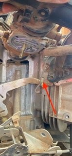

More pictures of the hus linkage. It appears you can only attach a few at a time.
Thanks for the pics, helped me verify I connected most correctly, only thing I didn't see was called the choke return spring. Not sure where it hooksMore pictures of the hus linkage. It appears you can only attach a few at a time.

take a new photo then edit it to 12" on the longest side with the resolution set to 72 dpi.
The thumbnail link is actually bigger than the photo and neither show me what you are looking for
the springs are a B & S part not a Husqvarna part
B &S have all of their parts lists on line as a free ( my kind of price ) download
according to the above mentioned IPL the governor & idle springs come as a set
that engine specification has an individual choke & throttle control so the choke is a solid control. no spring.
