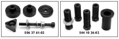

I’m looking to purchase a crankshaft puller to pull it through the bearings once they are installed. Does anyone know where I am purchase one of these? Thanks in advance
That when you need to engineer you own tools.Thank you, but there has to be a cheaper alternative.
Not sure which one of these I would need for the Husqvarna k760. Any thoughts? ThanksActually there is two tool kits and get ready to have very deep pockets as both will set you back about $500+. Google the following part numbers.
For bearing installation. PN 506376102 Bearing Press.
and
For crankshaft installation. PN 544103602 Crankshaft installation tool kit.
