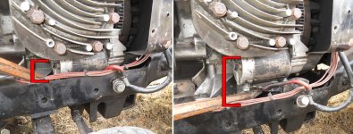

Today I managed to loose the PTO belt, open the four bolts and look at this, image below, I think there's enough room to replace the start motor...
Looking good. If everything goes okay, then I'll have the start motor replaced soon!
Above left, the space before lifting the engine. Right, engine bolts open, engine lifted.
I marked with red the space.
Note: not easy to just open/loose some nuts and bolts. Incredible. It took me a great effort and 1/2 hour to get some bolt opened.
