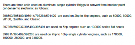

Star, can you post that Briggs magneto electronic conversion chart. My seems to have grown legs and walked away. Thank You.

11,489
Here is a copy from my cheat sheet here. Now some the PN may already superseded again.
