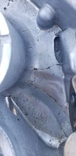

Hi. I attached a photo of the old sump. It has several lines which certainly looks like cracks. They may be casting marks but the new one I bought didn't have those lines.
Yes it is a crack but it is a casting flaw and should have gone back into the furnace not on an engine .
But that is a good start so we now know we are not looking for some other damage .

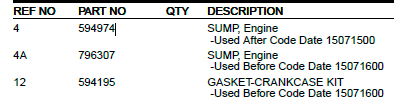

Reference IPL.
The sump was change July 16, 2015. The OPs engine was made July 18, 2016. So first did the OP order the correct sump (594974)? If so then no gasket other RTV was used.
Now the earlier sump did use the 0.015 Gasket and new screws.
As for the old sump I see both castings and cracking.
