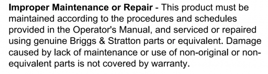

Just a heads up using non OEM filters. If you use anything other than OEM Filters on a new engine be it for vehicle, mower, etc. & the engine locks up, internal damage, etc. you can be held responsible & warranty will not cover cost.
Can you show me where it says that in the warranty and/or Operator's manual?
Here, this is what you're probably talking about...
All they're saying here is they're not going to give you a new engine if your new Fram filter had a mouse living in it and it kills the engine due to stopping the flow of oil. The same goes for pretty much any manufacturer. Why would Briggs pay to fix your machine if Fram breaks it?
If Briggs sold something as good or better I'd use it. But Briggs has a strategic partnership with Champion, which is who makes those Briggs oil filters. So I have to do what I know is best because I already know I will own this thing well beyond the term of the warranty.
