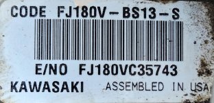

I recently cleaned the carburetor on an FJ180V. I found that in reinstalling the carburetor it is difficult to snake it around the intake manifold and hook up the throttle/choke linkages. I also don't want to mess up the new gaskets. Is there a simple trick to completely remove the intake manifold first to gain access to the mounting location? This is the FJ180V with the flat air filter, not the cylindrical filter as is now used on the Kai engines. I am including photos including the engine ID tag to help explain below. Thanks in advance!

I am having a tough time finding a 180 with a protruding horn from the intake manifold; there should be just two gaskets and an insulator. Can you provide the model code, i.e., fj180v-cm03, please? Remove the intake tube so you have some room to work or simply remove the air filter housing intact. I would replace all the gaskets, as they are rough but may still work okay, as the inner sides close to the carb bore are intact. Once the air filter tube is removed, you should be able to angle the carb easier to get first the choke linkage, then the throttle linkage and spring hooked up. That breather tube is rough, and I recommend replacement to prevent ingestion, being that it comes in after the filter. Please get back to us with the full model number. Thanks

It's a Snapper spec engine with a 25mm crankshaft but I don't recall the full model code. Sorry, but I'll look for it.
