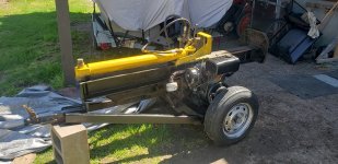

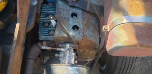

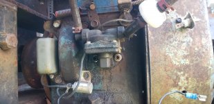

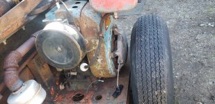

Can anyone identify this engine for me!
Crazyjoe Forum Newbie Joined Jun 13, 2020 Threads 2 Messages 5 Apr 26, 2021 / Engine ID #1 Can anyone identify this engine for me!
R Rivets Lawn Royalty Joined Mar 11, 2012 Threads 55 Messages 14,681 Apr 26, 2021 / Engine ID #2 If it is around a 5Hp, my guess is a Kohler K91.
Crazyjoe Forum Newbie Joined Jun 13, 2020 Threads 2 Messages 5 May 2, 2021 / Engine ID #3 Ends up the engine is a K-301, 12 hp,the problem was a bad condenser. She runs great and I get her some new paint! Attachments 180856046_3839192036136550_2337525129732442946_n.jpg 244.4 KB · Views: 2
