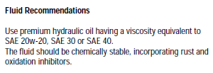

I have found mobil 1 20W 50 both recommended and not recommended .
The Eatons manual just says high grade hydraulic oil
The swisher manual says "call the dealer "
Eatons service agent just said ISO 68 hydraulic oil
