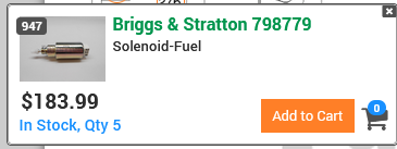

My one concern is the connection for the fuel cutoff solenoid. The connector is not keyed so the wire can connect either way. I have tried both was - no difference. I would still like to know if the black wire is up or down.

Doesn't matter which way the connector is plugged in.
And boy Briggs got proud of these solenoids. Actually ridiculous priced.
Just make it is working by feeling its operation as you turn the ignition switch to run. Also can temporary bypass it by using a M8-1.00 x 5mm screw.
