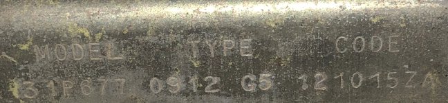

I have a craftsman lawn tractor with a Briggs and Stratton 19.5hp engine vertical shaft model 31p672 0912. G5. I'm trying to find out what this part is, I'm thinking it's at least part of the fuel pump? If someone can please help I would greatly appreciate it. 20230421_200526.jpg20230421_200815.jpg

Here is the picture of the model number 78251CBA-D304-4188-81D0-211C42C4F710.jpeg

Here is the picture of the model number View attachment 63988

31P677.
