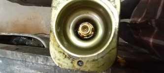

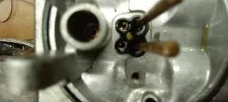

all it was, was a dirty carb. nothing else. i figured it was based on it having power and when i pulled one plug wire at a time it did not reduce rpm's much for each side. it did not smoke or sputter. and i did not get a poke from the wires when grabbing them so the wires are ok. but because i had to choke it i kind fof figured the carb may have been dirty. but was hoping would have gotten some confirmation here. but anyway it runs well. and for 150$ it is a dandy machine. here is what i found engine was not full of debris bowl had junk in the bottom and in the main jet and the idle ports one was plugged just like the YT videos showed. thanks for the ideas but i kind of figured the carb was the culprit.
