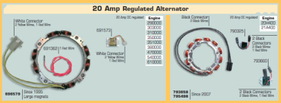

Hi All, can anyone tell me the correct R&R for this stator, it’s a 20 Amp.
Geochurchi Active Member Joined Aug 16, 2021 Threads 23 Messages 69 Feb 5, 2023 / B&S regulator/rectifier #1 Hi All, can anyone tell me the correct R&R for this stator, it’s a 20 Amp.
StarTech Lawn Royalty Top Poster Of Month Joined Feb 19, 2020 Threads 79 Messages 10,255 Feb 5, 2023 / B&S regulator/rectifier #2 There is two regulators that fit that connector 790325 and 793660. Need engine model and type number to know which one it is.
Geochurchi Active Member Joined Aug 16, 2021 Threads 23 Messages 69 Feb 5, 2023 / B&S regulator/rectifier #3 Engine # 3054473079 G1 V twin, not mounted on conventional equipment. Geo
StarTech Lawn Royalty Top Poster Of Month Joined Feb 19, 2020 Threads 79 Messages 10,255 Feb 5, 2023 / B&S regulator/rectifier #4 Someone has done a refit of the stator as originally it came with the 10-16 stator. In this case I think the best option is to get the 790325 regulator unit. Just make the regulator is grounded to the engine and frame.

You are correct about the refit, those numbers do not appear to be B&S numbers , is there a cross reference?

The two PNs I quoted are Briggs part numbers. Of course you need to shop around for the best price. Probably eBay.
