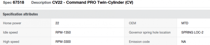

what is the spec number?
76
10,225
8mm governor shaft version
or just in case you had engine before serial 3004604141 here is the 6mm version.
