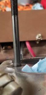

Hello, I have a grasshopper 725K with a Kohler command pro CH742. The exhaust rocker arm bolt came loose and the arm rolled off the spring on Cylinder 1. I am in the process of putting new heads on it and have ran into a couple questions before I go any further. Of the 4 head studs the top 2 on both cylinders are threaded out about 2 or 3 threads. I wanted to make sure this is normal or not. Also anyone know the torque specs on the rocker arm bolts, and valve covers. Thanks!
