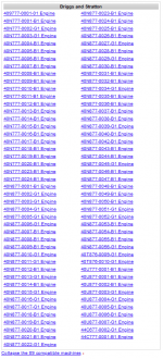

First according the IPL the kit is PN 694012. Second just note those bolts pictured are not head bolts but are for the oil sump pan (oil pan, closure plate or whatever you wish to call it).
The 694012 covers these engines.
The 84001915 kit for the following engines.
Your choice. The Kit PN Bert does contains head gaskets that have a fire ring which make them a better choice but the kit may not contain all the correct gaskets for your engine. Also if the 84001915 was a supersede kit for the 694012 Briggs would have noted such in the latest price file that I downloaded in late October 2021.
