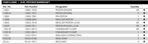

Whoa here PN 13001-7031 is a std piston not a set of rings. If you have a 0.50mm over rings then you must have PN 13025-7010 or the wrong rings. Now the 13008-0583 is the std rings set. Std bore is 73mm.
AR = As Required

Right on my piston the number is 13001-7031, yes I know that.
To put this to rest I bought ring set 13008-0583 for this piston.
